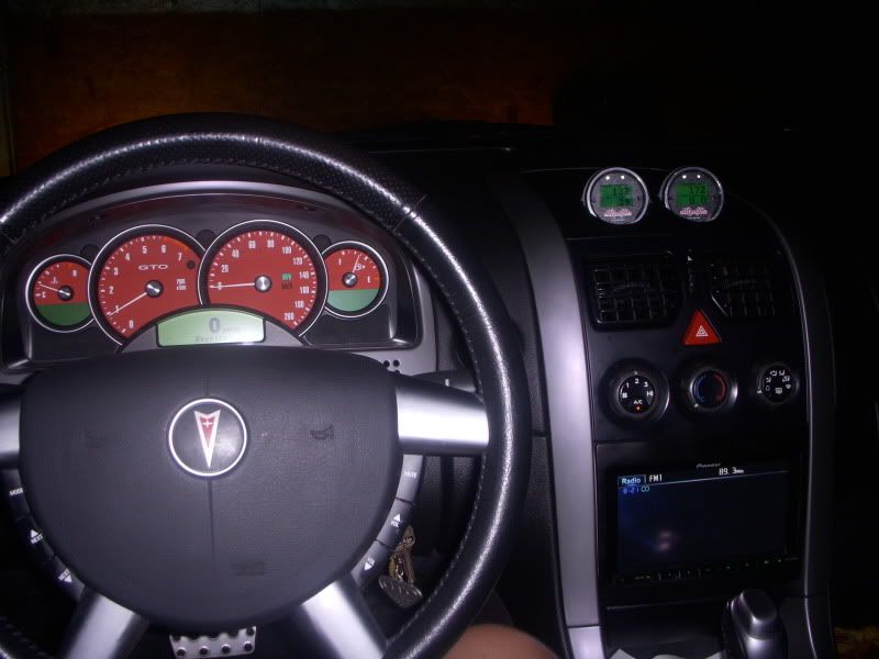

I installed the Gauge pod and gauges a couple of months ago. IMHO the gauges are great. They can read all kinds of information about your GTO, and what's going on.
Before installation go to http://www.aeroforcetech.com/manuals.html and choose your gauge. The one for the GTO with the latest gauges is 3.4.
Here are photos showing the install and what I did.

I'm very pleased with the gauges. Both gauges will read 2 different items, and right now I have them reading Oil Pressure and Temp. on one, and Intake air temp, with ambient air temp on the other. Like I said before, you can read all kinds of things on these gauges.
Hope this helps someone with the installation of a gauge pod with gauges.

I was intimidated by the whole idea of removing the top cover and fishing the wire through, but it was a easy install. Once started, it took about 2 hours, and that's with taking the pics along the way. The Aeroforce Interceptor gauges are great. They just plug and play. Yes, they have oil pressure. Here is a list of paramaters and features of the gauges, as well as more info.

The Aeroforce Interceptor gauges are great, mainly because of what you mentioned. One feature I really like about them is that they read 2 parameters on each gauge, so it's like having 4 gauges installed. Also if you want, you can scan up to 8 different parameters on each gauge. When you order the dual gauges setup it comes with the wires already spliced together, with the OBD2 connector ready to feed both gauges. I don't know anything about the scss gauges.
