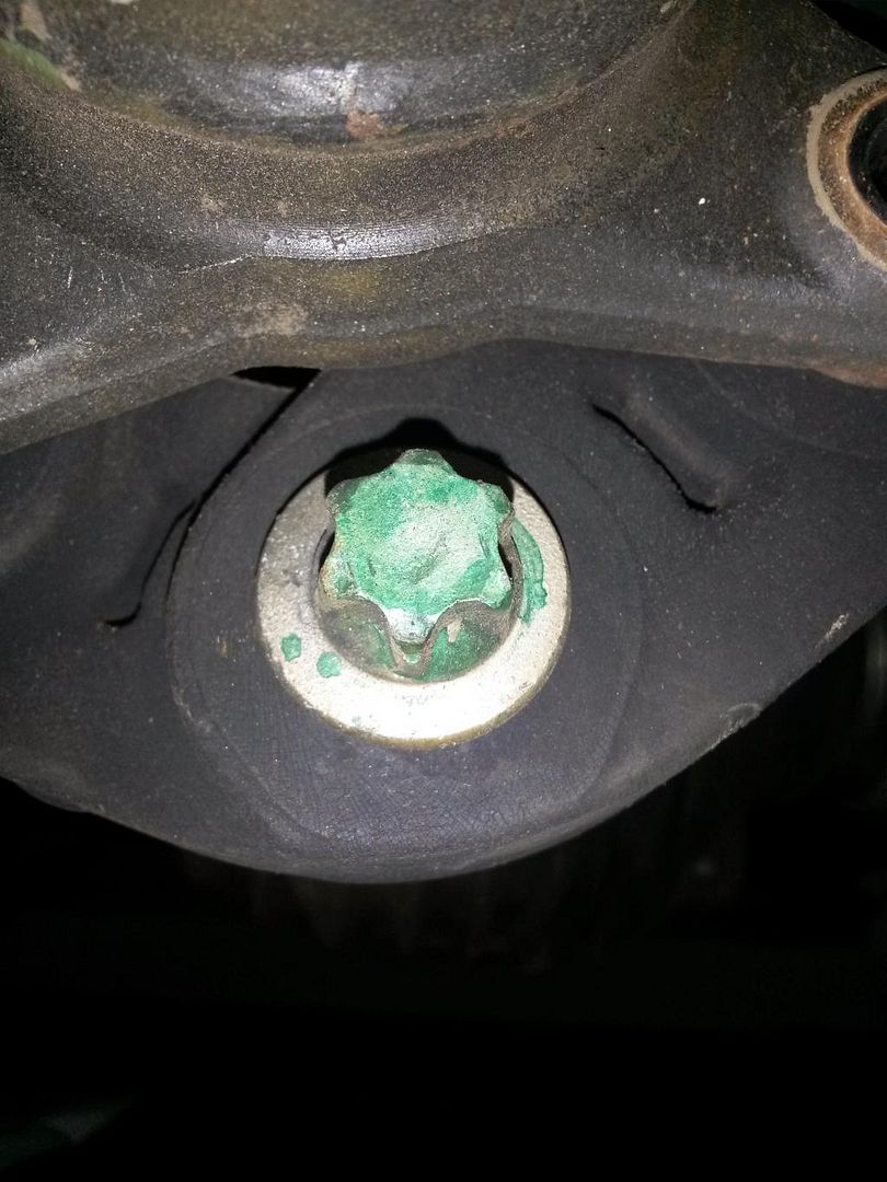

E18 bolt head. You could have used an hex 14mm socket but i didn't want to take a chance.

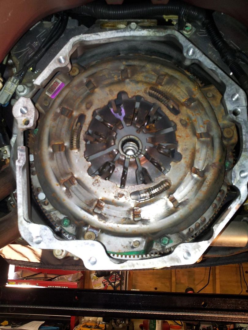

Here are some pics of the removed parts and the transmission on the transmission jack.
My factory clutch i believe. The car has 13,500 miles on the clock.
Flywheel is in excellent shape too. A few spots here and there.

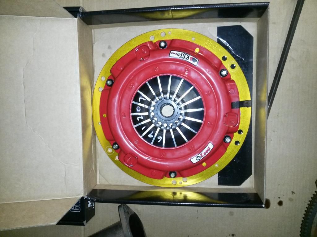

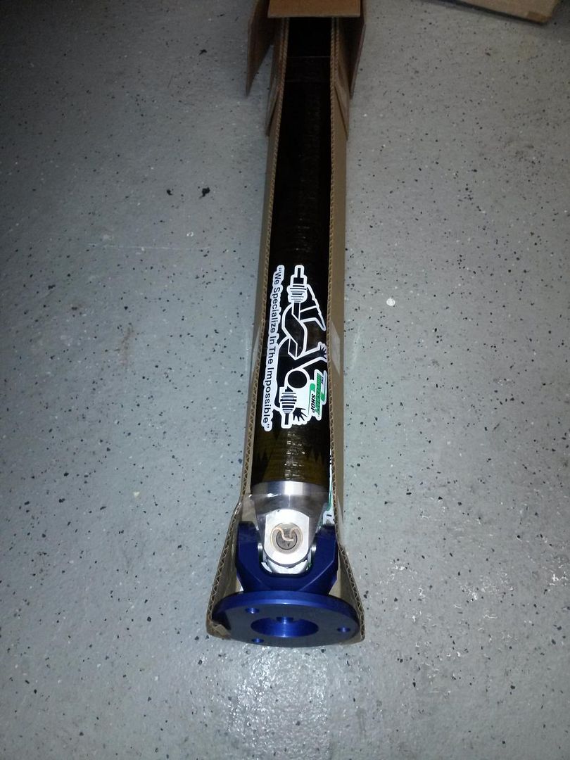

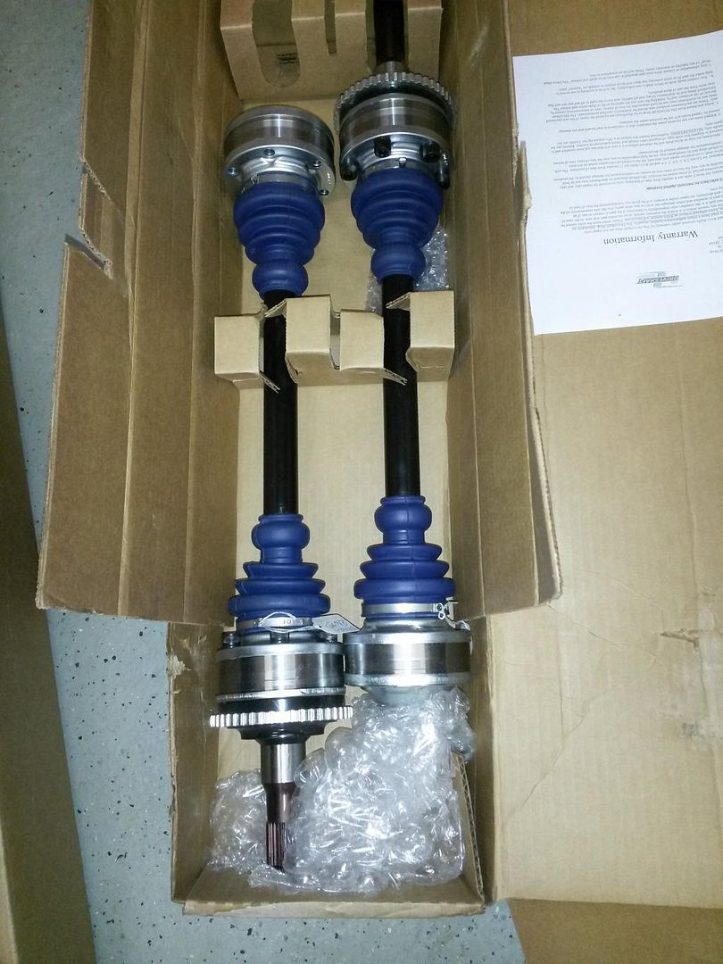

Some new parts that will be going on the goat.

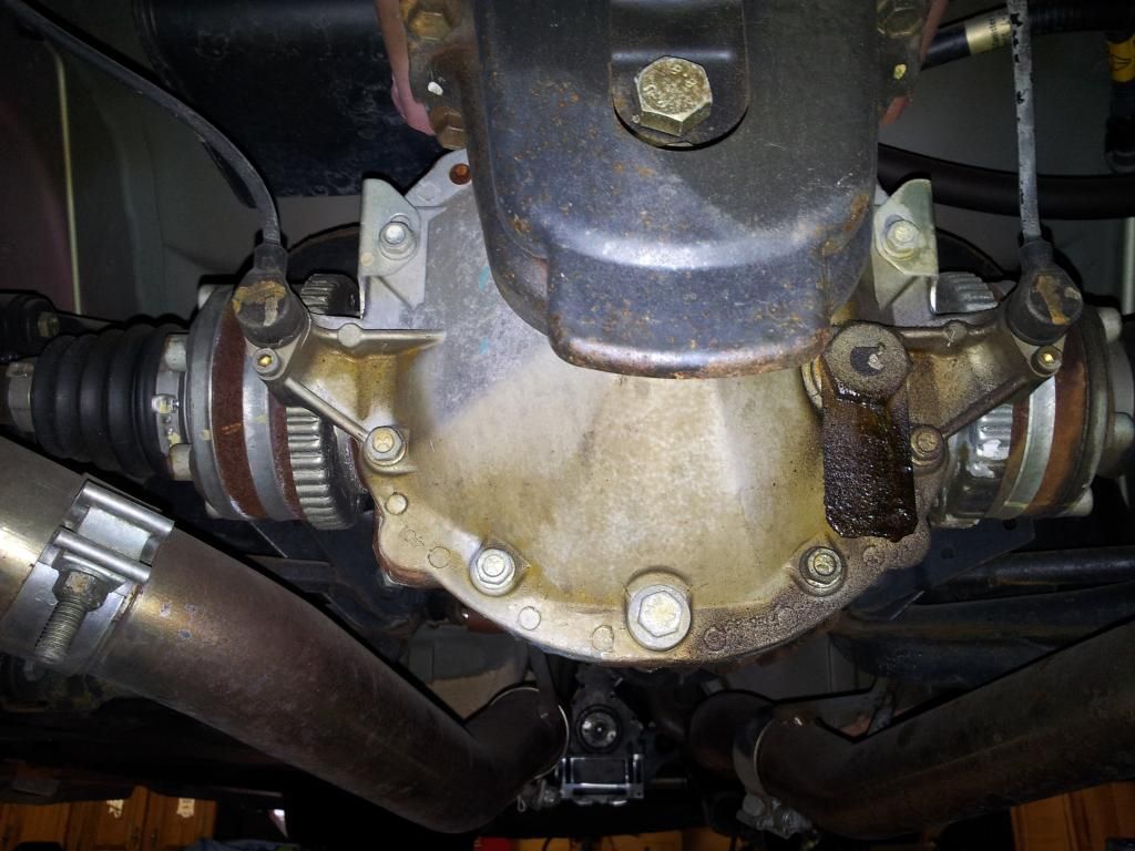

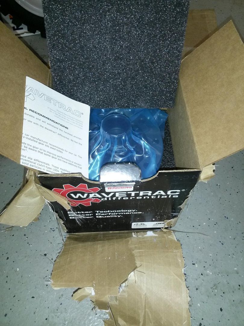

Almost forgot! Mike, this will be heading to you soon. I wish the snow and cold would stop. The removal of it looks pretty easy and straight forward.
